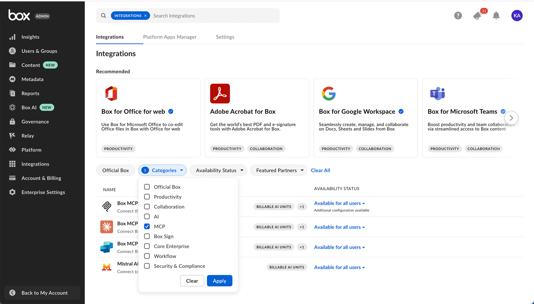

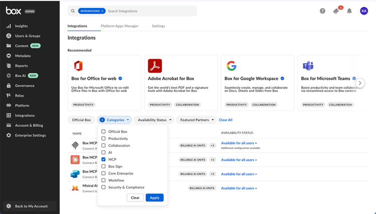

Access and manage predefined Box MCP servers
  1. Click Integrations in the sidebar of Box Admin Console.
  2. Use Categories filter and choose MCP or search for a predefined Box MCP server in the search field at the top of the window.
  3. Beside the selected MCP server, click the state, then select the state you want to enable.
