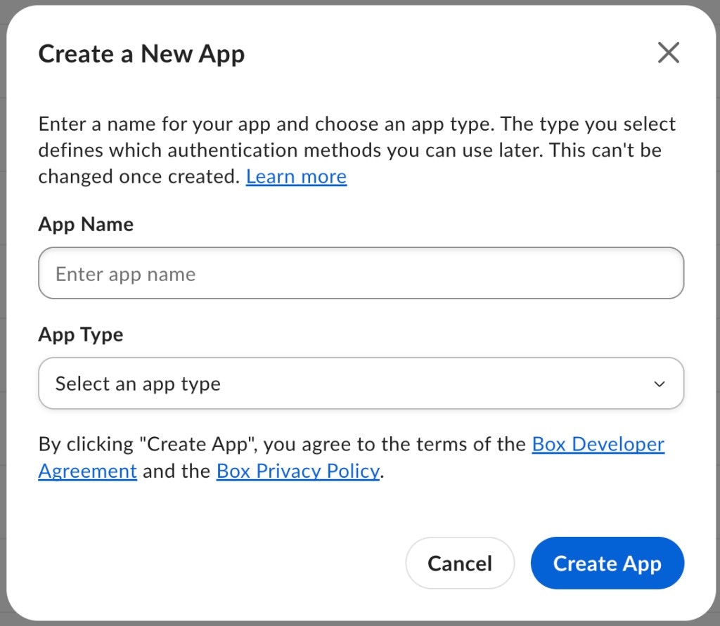

Create a Server Authentication app
  1. Log into Box and go to the Developer Console.
  2. Select New App.
  3. Select Server as the app type.
  4. Leave Client Credentials Grant selected under Select Method.
  5. Select Create.
Client Credentials Grant (CCG) is preselected for new Server Authentication apps, so selecting Create without changing the method produces a CCG app. Your enterprise’s Switch server app auth type (CCG or JWT) setting only affects whether you can change the method later. It is enabled by default for free developer accounts and disabled by default for enterprises, so in an enterprise treat the method as fixed once the app is created.

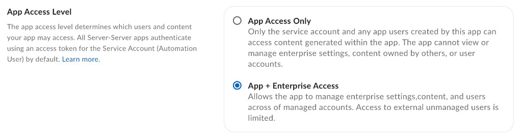

Application access
An application’s access level determines which users and content your app can access. By default, an application can only successfully interact with the content of its and any . To also access existing Managed Users of an enterprise, navigate to the App Access Level setting on the Configuration tab of the Developer console and set to App + Enterprise Access.
App access level
To authenticate as a Managed User or Admin, enable Generate User Access Tokens in the Additional Configuration section of the Configuration tab.
