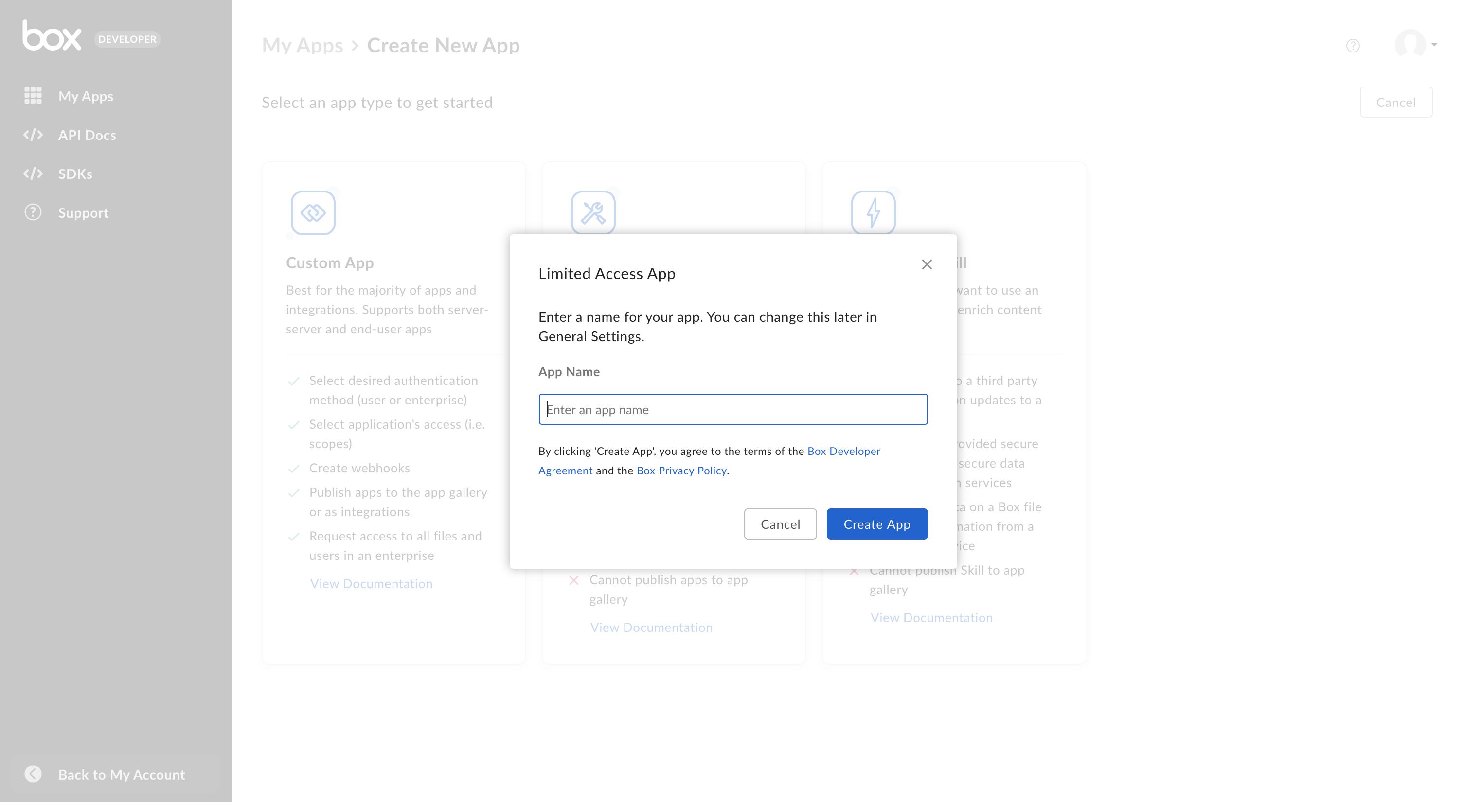

3. Select an app name
Finally, select a unique name for your application and click Create App.
App name form
