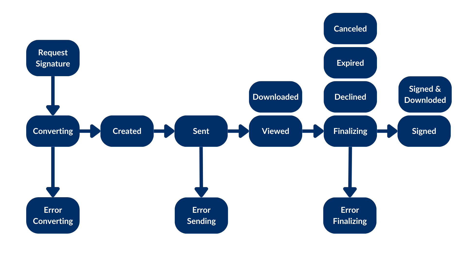

Check the status of the signature request
Creating the signature request is an asynchronous process, and can generate errors. Your application should check the status of the request before proceeding, and handle any errors. A signature request can have the following statuses:
Signature flow
  • converting: The file is converted to a .pdf for the signing process once the sign request is sent.
  • error_converting: An issue occurred while converting the file to a .pdf.
  • created: When the document_preparation_is_needed is set to true, but the prepare_url has not yet been visited.
  • sent: The request was successfully sent, but no signer has interacted with it.
  • error_sending: An issue occurred while sending the request.
  • viewed: The first, or only, signer clicked on Review document in the signing email or visited the signing URL.
  • downloaded: The document was downloaded by the signer.
  • signed: All signers completed the request.
  • signed and downloaded: The document was signed and downloaded by the signer.
  • declined: If any signer declines the request.
  • cancelled: If the request is cancelled via UI or API.
  • expired: The date of expiration has passed with outstanding, incomplete signatures.
  • finalizing: All signers have signed the request, but the final document with signatures and the signing log have not been generated yet.
  • error_finalizing: The finalizing phase did not complete successfully.
